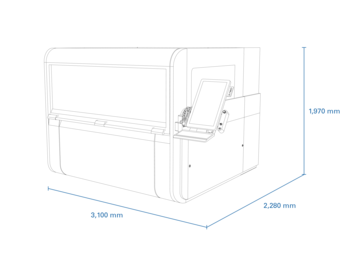

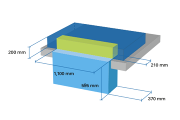

MLCube & MLCube LS - Your benefits at a glance:
  • Extremely large working area requiring little floor space.
  •  New vacuum clamping technology with the possibility of electrically enabling/disabling different segments.
  •  Available with table cutout for vertical clamping technology, appropriate for machining high components (optional).
  •  Contour smoothing package PerfectCut for fast, accurate and contour faithful HSC milling with excellent surface quality: your machine is more powerful and stays “fit” longer, even in cases of high-    volume production (optional).
  •  New chip carriage design with allocation to multiple containers (stackable) to promote work ergonomics.
  • Optional with linear encoders in x- an y-axis (DATRON MLCube LS)
