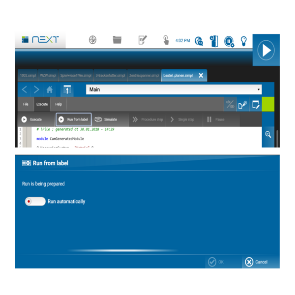

Execution of a programme starting from a label

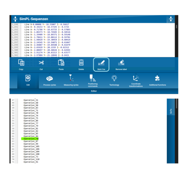

To increase the flexibility in executing programmes, it is now possible to start a milling process in the editor from any desired programme line. To do this, proceed as follows:
- Place the cursor at the desired programme line in the editor.
- Select the option “Zeile markieren” (Mark line). The line will be highlighted in green.
- In the “Execute” menu, choose “Run from a label”
- Programme execution is then prepared and a corresponding dialogue, which must be acknowledged at the end with “OK” to start execution, is displayed.
The preparation may take a while, depending on the size of the programme. If you do not want to wait, you can start the programme directly after the end of the calculation by activating the option “Run automatically”.
Note: If the mark is within a programmed loop, an additional dialogue to define the number of runs will be displayed.

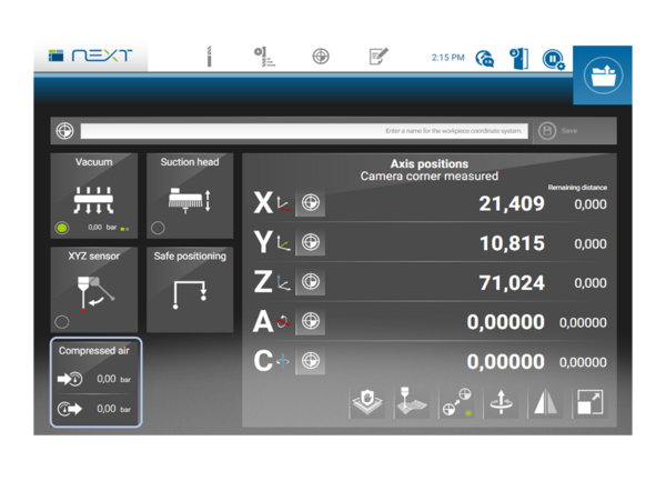

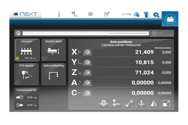

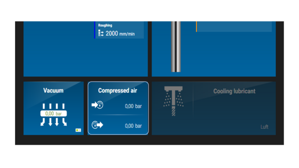

Compressed air status display (not for DATRON neo)
The compressed air status can now be displayed on M8Cube, MLCube and M10Pro machines with the DATRON next control system. Display elements are located in the section “Work piece setup and “Runscreen”. The control element for pressure displays the value of Pin (input pressure) and Pout (output pressure).
Please Note: To activate the functions to display the status of compressed air and vacuum, as well as for vacuum monitoring, changes to your machine configuration to be performed by DATRON Service are required. Please contact service@datron.de so that the necessary settings can be made. Please note that this requires access to your machine using Teamviewer.

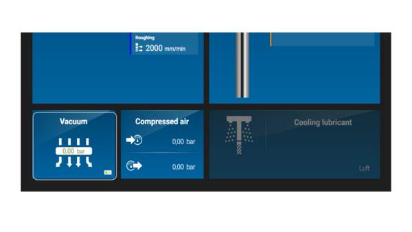

Vacuum status display (not for DATRON neo)
The vacuum status can now be displayed on M8Cube, MLCube and M10Pro machines with the DATRON next control system. The prerequisite is that the machine is equipped with a vacuum distributor with appropriate sensor technology. A corresponding control element showing the vacuum value is then displayed in the sections “Work piece setup” and “Runscreen”.
- Hint: The element displaying vacuum is provided with a green progress bar similar to the spindle speed, allowing you a better follow-up of how vacuum develops within programme execution.
- Please Note: To activate the functions to display the status of compressed air and vacuum, as well as for vacuum monitoring, changes to your machine configuration to be performed by DATRON Service are required. Please contact service@datron.de so that the necessary settings can be made. Please note that this requires access to your machine using Teamviewer.

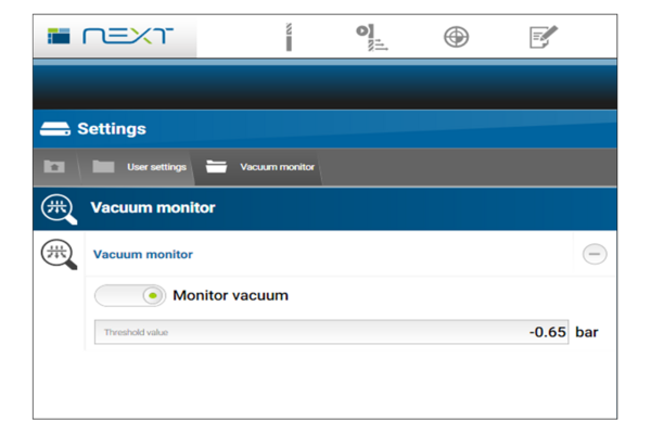

Vacuum monitoring function (not for DATRON neo)
There is now a function for vacuum monitoring to increase milling process reliability. If it is activated, the milling programme is paused as soon as the vacuum value falls below a threshold value. The operator then has the option of cancelling or resuming programme execution.
- Note: The threshold value is pre-set to -0.65 bar. Please note that this value does not offer any guarantee concerning blank displacement on the machine table during machining. For this reason, we recommend adjusting the value to your individual requirements

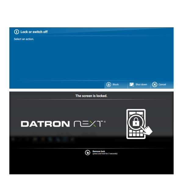

Screen lock
It is now possible to protect the screen of DATRON next with a lock function against undesired operation. To activate the lock, press the “next” symbol (top left) for 3 seconds and select the option “Block” in the subsequent dialogue.
Note: To unlock the screen, hold the touch screen anywhere for 2 seconds.

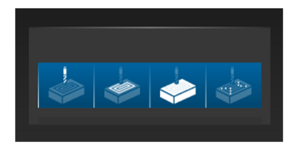

Graphical simulation icons in the 3D view
The icons in the 3D view have been redesigned to have a more similar look to the design in your machine.

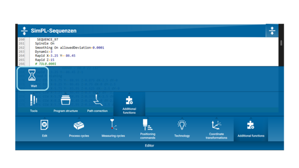

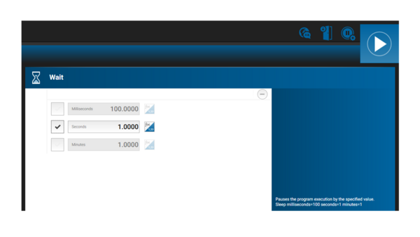

New SimPL command “Sleep”
As of now, you can use the “Sleep” command in a SimPL programme. The command can be added directly to the programme via text input or via the corresponding input dialogue.
The command is used to pause the execution of a programme for a desired period of time. As soon as the code line with the “Sleep” command is reached, the programme execution pauses for the specified duration.
Command
Sleep minutes=1
seconds=1
milliseconds=100 Parameter “minutes” (optional): Number of minutes to pause the execution of the programme.
Description
Parameter “seconds” (optional): Number of seconds to pause the execution of the programme.
Parameter “milliseconds” (optional): Number of milliseconds to pause the execution of the programme.

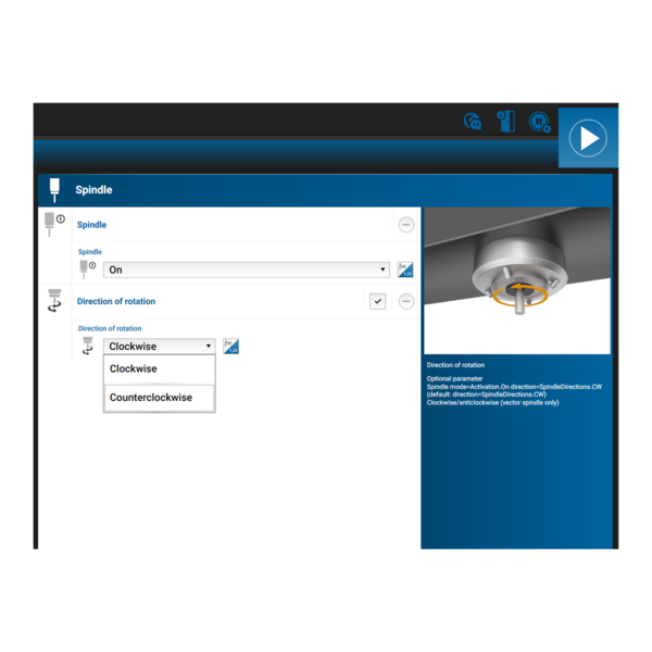

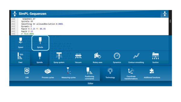

Extension of the SimPL command “Spindle” with the parameter “Directions”
The command “Spindle” has been extended with the parameter “Directions”. This allows to determine the direction of rotation of the spindle. The new parameter can be added directly to a programme via text input or via the corresponding input dialogue.
Command
Spindle mode=On direction=CW
Description
New parameter “direction” (optional). The values available are “CW” (ClockWise) and “CCW” (CounterClockWise).
Note: The use of this command requires a spindle with right/left rotation.
