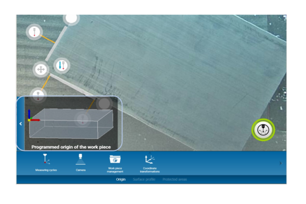

Display of the programmed workpiece origin in the camera stream
For better orientation during visual setup, an auxiliary graphic is now displayed on which the programmed workpiece origin is displayed. This makes it easier for the operator to select the right corner for probing.
Hint: The prerequisite is that the zero point is also programmed in the loaded program.

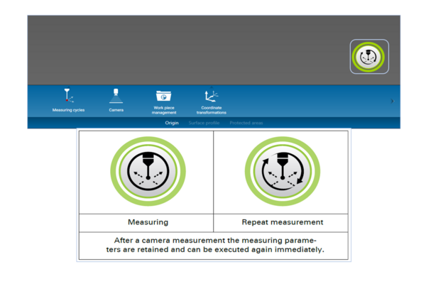

Repeat the last measurement of the camera
It is now possible to repeat the last measurement of the camera. If, for example, several components are machined one after the other at the same position, it is not necessary to draw a measurement vector each time.
Hint: The Measurement icon in the bottom right corner of the camera image changes after a measurement has been performed and becomes the Repeat Measurement icon.

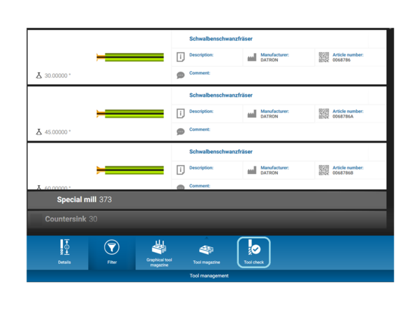

Calling the tool check from tool management
The Tool check of the currently loaded program can now also be called directly from the Tool management. It is no longer necessary to switch to the Program management to call this function.

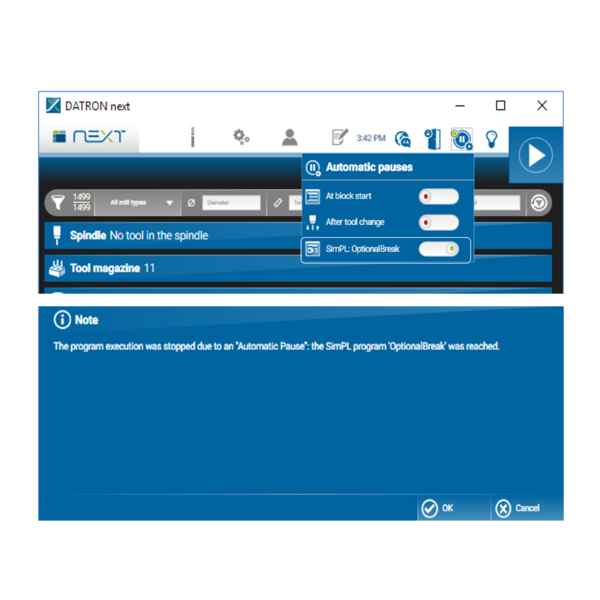

New Automatic pause: SimPL: OptionalBreak
With the DATRON next 2.2 there is another Automatic pause. A programmed optional pause.
If you insert the SimPL command OptionalBreak into a program and then activate the option SimPL: OptionalBreak in the dialog Automatic pauses, the program execution is interrupted at this point and a hint dialog appears. This must be confirmed with OK to continue the program execution (see screenshot below). This makes it easy to insert an interruption at defined points in the milling program – this is especially interesting when running programs in, if you want to check critical points in between.

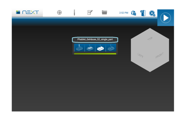

Name of the loaded program in 3D View
As of Release 2.2, the name of the program is displayed in the 3D view for a better overview. This way it can no longer be confused with other programs that were loaded in the editor but not simulated.
