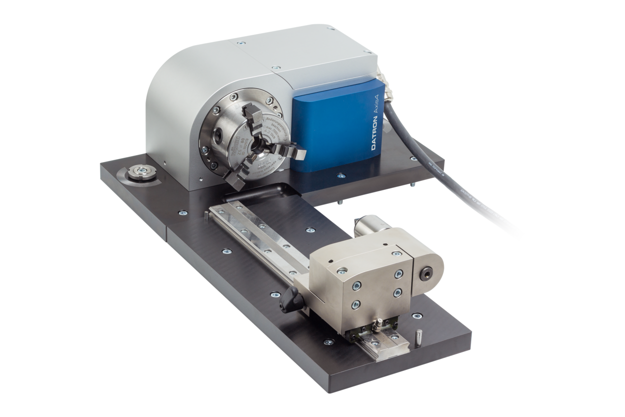

Axis4
Expand your machining capabilities with the DATRON Axis4. Ideal for multi-sided machining and round engraving, this compact rotary axis offers high precision, easy integration, and plug & play functionality. Positioned on the machine table’s left side, it boosts flexibility and efficiency for your DATRON neo.
DATRON Axis4
Product Features:
  • To extend the possibilities with regard to multi-sided machining, round engraving
  • Positioned on the left side of the machine table
  • A module clamping plate with centring cone and a recessed grip enables fast and precise positioning on the machine table
  • Easy to retrofit
Technical specifications:
  • Center height: max. 55 mm (different when using the optional accessories)
  • Plug&Play capability
  • Mounting: Flat surface with D=106 mm nd centric fit (34h6)
  • Drive: 200 Watt AC-Servo with toothed belt, multi-turn absolute encoder
  • Modulo-360° operation
  • Resolution: < 0,0001°
  • Maximum speed: 60 1/min
  • Dimensions (X x Y x Z): 109 mm x 244 mm x 145 mm
Scope of delivery:
  • Rotary axis on module clamping plate
  • Rotary axis control
  • License 4th axis for DATRON next control unit
Optional accessories:
The optional accessories for the rotary axis will be arranged according to your requirements
  • Axis4 tailstock
  • Axis4 three-jaw chuck
  • Axis4 centric clamps

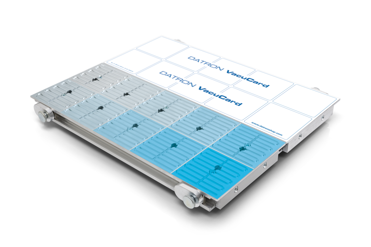

Secure and easy sheet material clamping with the DATRON neo Vacuum Set. Designed specifically for the neo platform, it ensures high holding force through segmented vacuum plates. Combined with VacuCard sacrificial layers, it delivers clean results and saves setup time—perfect for flat parts and serial production.
Vacuum Set
DATRON vacuum module clamping plates offer maximum clamping force and ease of use, achieved by the special DATRON vacuum distribution. Two vacuum plates specifically designed for DATRON neo are operated separately via connectors recessed in the worktable. Each plate is subdivided into 10 segments that - depending on component size - can be activated individually. To distribute the vacuum optimally below the workpiece, we have developed the DATRON VacuCard, a special cardboard, which serves as a sacrificial layer.
Description:
  • For easy and secure clamping of sheet material
  • Includes all accessories and consumables required for use of DATRON neo vacuum technology
Scope of delivery:
  • 2x vacuum module clamping plate 500mm x 200mm (includes limit stop rings and mounting material)
  • 1x vacuum pump
  • 50x VacuCard 500mm x 200mm
  • 50x VacuCard 500mm x 400mm
  • 1x vacuum key
  • 1x double flute end mill stepped with edge radius (for facing vacuum module clamping plates)

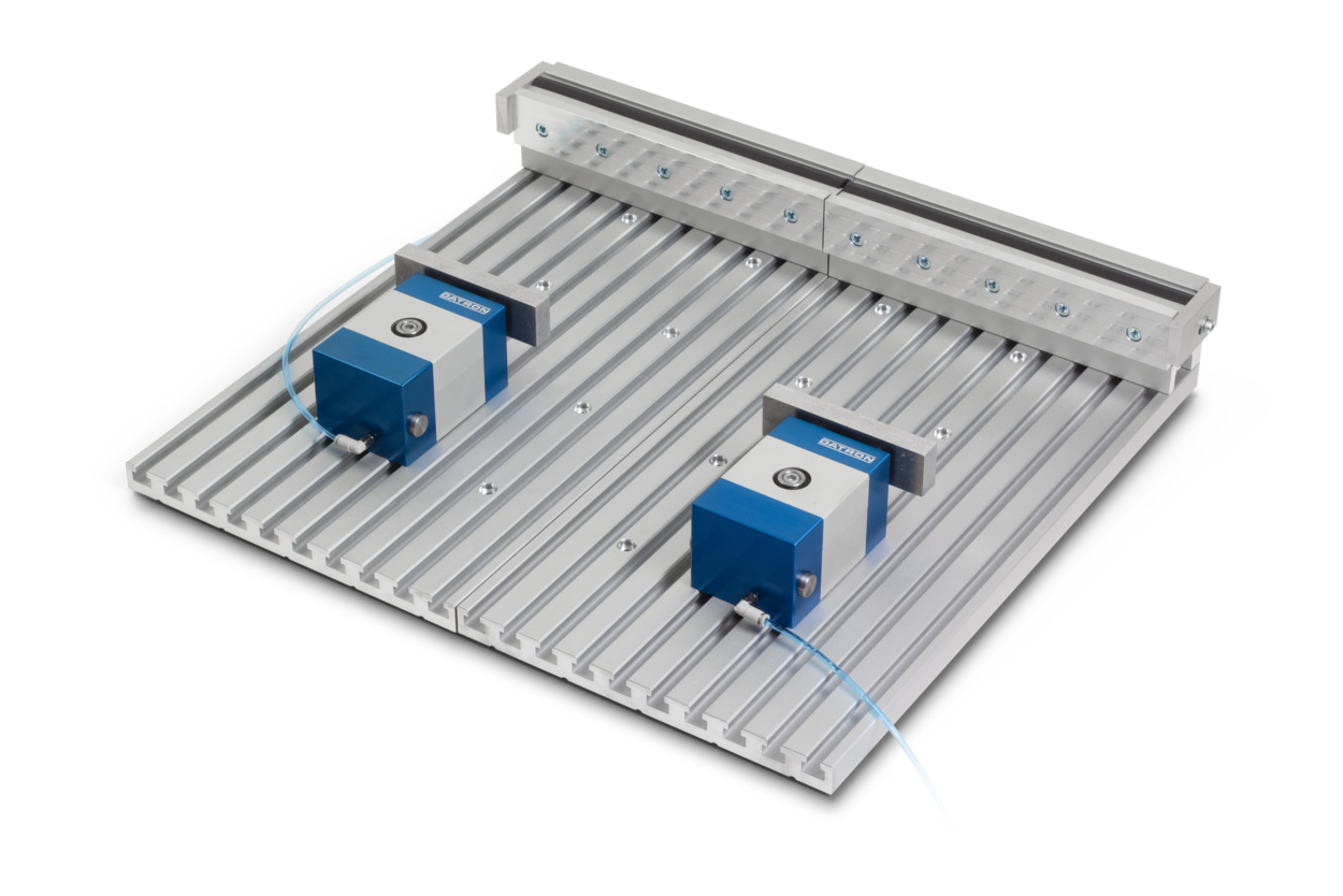

Speed up your job setup with the DATRON neo Pneumatic Clamping Set. Featuring a T-nut clamping plate and short-stroke clamps, it allows quick, one-handed part changes. Flexible and secure, this system is perfect for users who prioritize speed, repeatability, and ease of use in dynamic workflows.
Pneumatic Clamping
The pneumatic-clamping system moves with the click of a button to ensure quick job setup and changeover. According to your needs, you can use it on a T-slot plate or in stationary manner.
Description:
  • T-nut plate for flexible clamping capability
  • Short-stroke clamping element for quick and secure clamping of work pieces with one hand
Scope of delivery:
  • 1x T-nut clamping plate right
  • 1x T-nut clamping plate left
  • 2x short stroke clamping element KSE-PH
  • 1x dove tail milling tool

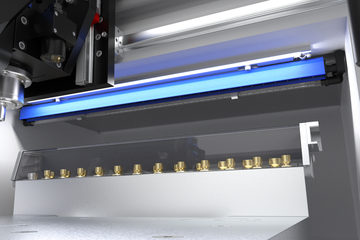

Ionizing Bar
The DATRON neo Ionizing bar facilitates chip management during plastic machining. The ionization bar discharges the adhering chips inside the machine, allowing them to fall into the chip box through compressed air. This significantly reduces cleaning efforts throughout the process.

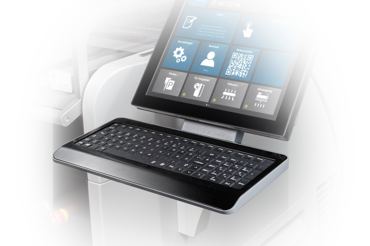

Keyboard Kit
Enhance usability with the DATRON neo Keyboard Kit. The dust- and waterproof USB keyboard (IP68) is housed in a durable metal mount, making machine operation even more convenient. Easily attach it to your display holder for streamlined control—ideal for workshop environments.
Keyboard Kit
Scope of delivery:
  • 1x USB keyboard black (dust- and waterproof according to IP 68)
  • 1x metal holder
  • 4x screws for mounting on display holder
  • cable tie
*Image similar

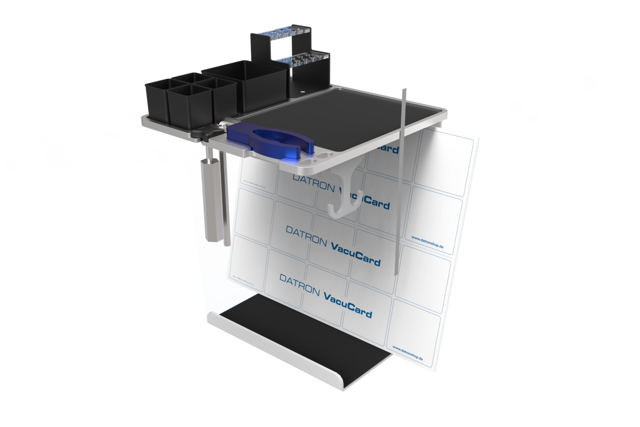

Table
Keep your tools and gauges organized with the DATRON neo Table. Designed for ergonomic access and storage, it’s vibration-damped and tailored to fit your machine setup. Integrated holders for collets, adapters, and accessories make tool changes faster and more efficient—right at your side.
Table
The DATRON neo table helps the user to organize tools and measuring equipment within easy reach.
Description:
  • Table for Datron neo for storing tools and measuring equipment, light anodised.
  • Vibration decoupled from the machine with rubber buffers
  • Storage field for measuring equipment, channel for pen, storage places for tools with d=10.5mm stop ring
  • Holder for adapter insertion tool for 6 and 8 mm collets 0068337D (not included in delivery)
  • Holder for insertion tool stop ring 8 mm shank tools 0068180A (not included in delivery)
  • Holder for the vacuum locks in the table and the corresponding 10 mm Allen key (not included in delivery)
  • Hook for compressed air gun

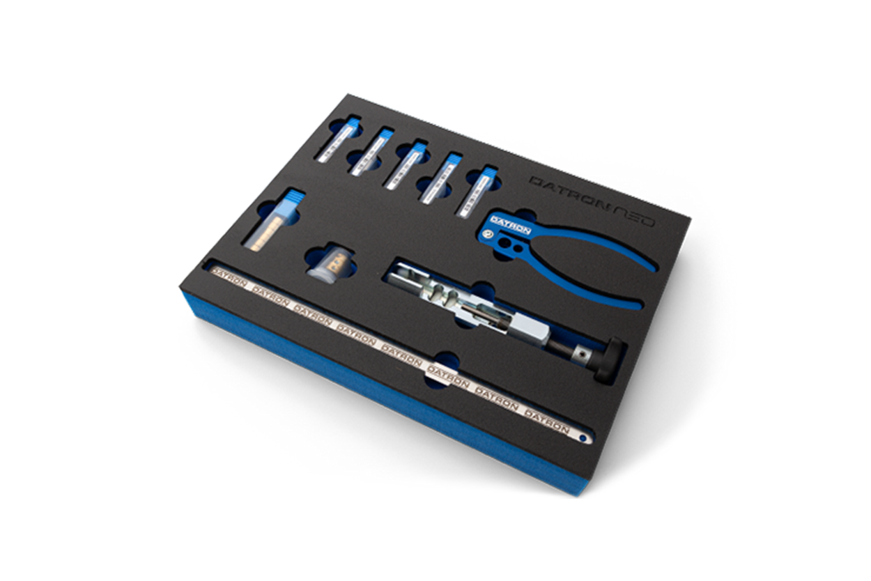

Starter Set
Get started with confidence using the DATRON neo Starter Set. This all-in-one kit includes collet adapters, stop rings, and insertion tools to support a wide range of tool shank sizes. It’s the ideal foundation for flexible machining and seamless tool setup on your DATRON neo.
Starter Set
Our DATRON neo Accessories to help you get started milling right away:
To use a wide variety of tools, you will also receive precisely manufactured adapters and stop rings. These allow the use of tools with different shank diameters. Also included are two ideal insertion tool.
Scope of delivery:
  • 1x adapter insertion tool for 6mm and 8mm collets
  • 1x insertion tool for tools with 8mm shaft diameter
  • 1x adapter collets 3mm to 8mm diameter
  • 1x adapter collets 1/8‘‘ to 8mm diameter
  • 3x adapter collets 6mm to 8mm diameter
  • 6x limit stop ring 8/12.5mm, brass
  • 3x limit stop ring 8/18 mm, brass
  • 1x steel
  • Ruler 300 mm

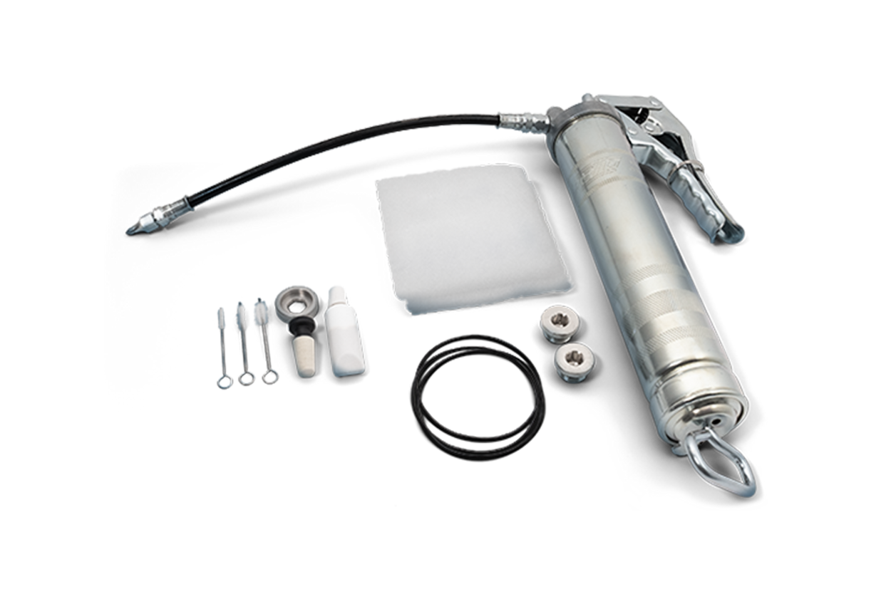

Maintenance Set
Ensure long-term performance with the DATRON neo Maintenance Set. This complete kit provides essential cleaning agents, lubricants, filters, and seals for preventive machine care. Keep your system in peak condition and avoid downtime—because consistent maintenance means consistent productivity.
Maintanance Set
Secure it to a permanent machine availability. With Our DATRON neo maintenance kit we provide you the necessary products for a careful preventive maintenance.
Scope of delivery:
  • Cleaning agents and lubricants
  • Filter and seal kit
  • Grease Press
