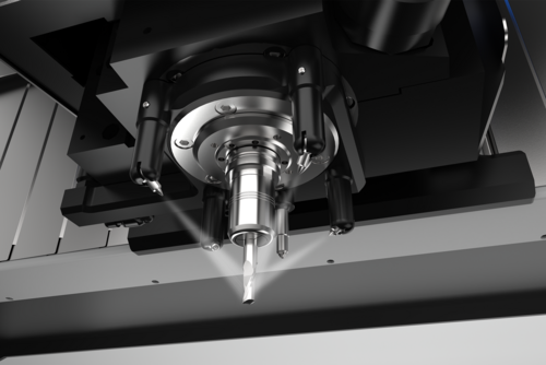

Minimum quantity lubrication
Up tp two coolant tanks, each with a capacity of 10 L – compactly and seamlessly integrated into the machine to save valuable space.
Accessories
High frequency spindles with speeds up to 60,000 rpm and high concentricity guarantee high cutting performance and perfect machining results when using small tools.

Ecologically and economically optimised processes with minimum quantity cooling lubrication and correspondingly increased durability.
