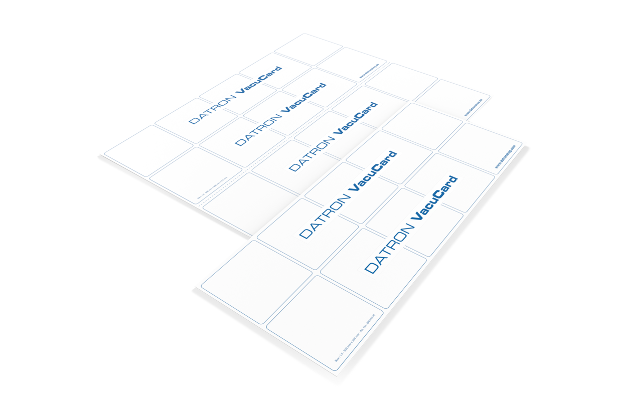

DATRON VacuCard
Optimize your vacuum clamping with DATRON VacuCard. This micro-perforated special cardboard ensures uniform vacuum distribution, protects the plate as a sacrificial layer, and eliminates the need to cover unused areas. Also available: DATRON VacuCard++ with adhesive grid for higher holding force, and DATRON VacuCard+++ with extra-fine adhesive pattern for very small parts.
More about the DATRON VacuCard++/+++
DATRON VacuCard++ – For enhanced holding force
The DATRON VacuCard++ is a patented sacrificial layer with an added adhesive grid structure (10 mm x 10 mm). Ideal for thin, flexible, or small parts.  It improves the holding force and reduces vacuum consumption. Perfect for high milling forces, rough surfaces and delicate workpieces.
DATRON VacuCard+++ – For very small parts & maximum grip
With a finer adhesive grid (5 mm x 5 mm) and stronger adhesive layer, the patented VacuCard+++ securely holds even the smallest and lightest parts—down to 10 mm diameter. It ensures high process safety during demanding machining tasks and offers uniform vacuum distribution. Best suited for very small components, prototypes, and small series production.

How to use the VacuCard++/+++
  • Place the VacuCard++/+++ between the vacuum plate and the workpiece.
  • Use a pico knife to cut the protective film around the part’s footprint.
  • Remove the cut film sections and place the part directly on the exposed adhesive.
  • Activate the vacuum and begin machining.
  • After milling, the part can be removed cleanly and safely.
