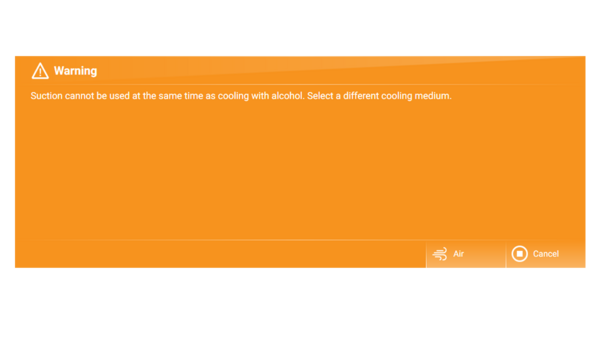

New warning message in case of simultaneous activation of suction and alcohol cooling
If suction is activated, alcohol must not be used as coolant because the it must not be cooled with alcohol, because the suction system is not explosion-proof. To prevent incorrect operation, a corresponding message is now displayed if alcohol is used as coolant by mistake when suction is activated.

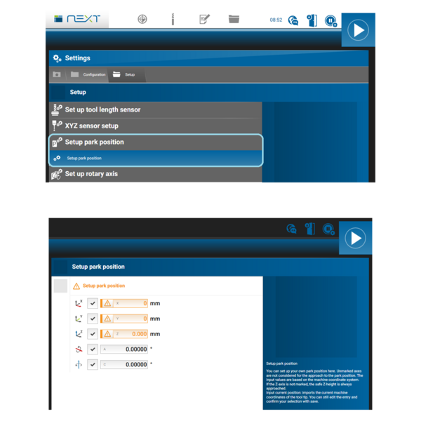

Parking position individually configurable
Due to multiple customer requests, as of now it is now possible to define the park position individually.

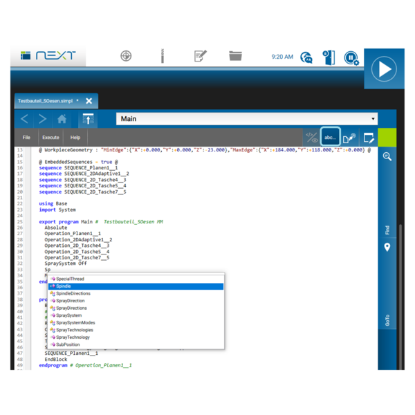

Autocomplete function in the editor
To make programming in the editor even easier, the autocomplete function is available as of now. It is activated via the abc… symbol at the upper right edge of the screen. Autocomplete suggests a dynamic selection list of available programme instructions and structure elements at keyboard input, so that they only have to be selected.

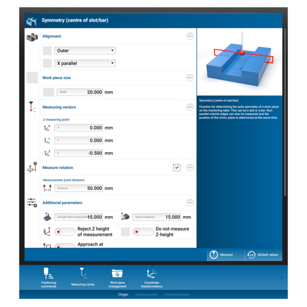

Innovations in the measuring cycles

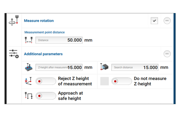

New optional parameters to measure rotation
As of now it is possible to measure the rotation of unmachined parts via further, optional parameters, in all measuring cycles (without camera) of the DATRON next control, in case a component is not lying parallel to the axes on the table.
Note: In the “Circle centre point” measuring cycle, the parameters for rotation measuring allow to measure the rotation of a blank by probing two holes in any position. HSCpro users know this function from the “two-hole rotation macro”
Suppression of Z measurement in the measuring cycles
The Z measurement can be completely suppressed, or the measurement result can be rejected in every measurement cycle if the previous result is to be used.
New symmetry measuring cycle (groove/bridge middle)
There is a new additional measuring cycle available for the determination of the symmetry axis of a workpiece. This is useful, for example, to determine the centre between two vice jaws.
Note: For further details on the new features in the measuring cycles, please refer to the DATRON next manual (Version 2.5).
