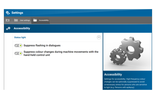

Suppression of high-frequency colour changes of the status light
NO purchase option | NO additional hardware required
In version 3.0, the important new “Accessibility” tab is found in the user settings.
Description of function
With this new function, light-sensitive machine operators have the option of preventively turning off the flashing light (flickering light) of the status light of the DATRON machine, for example to minimise the risk of an epileptic seizure.

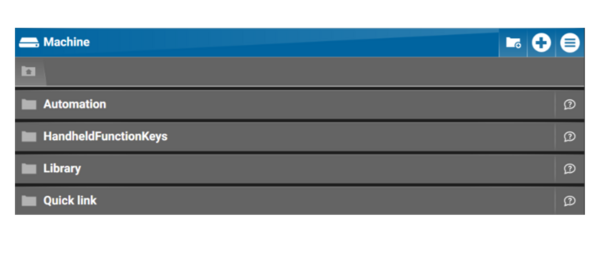

Use function keys of the hand-held control unit
Our hand-held control unit is an essential support for operators when working on the milling machines.
The function keys of our hand-held control unit have been given a new function: The operator can start a program with these keys to perform standard tasks.
  • There is a new folder in the “HandheldFunctionKeys” path
  • This folder contains SimPL programs.
  • Every key has a program.
  • They are linked to the keys by the module names.
    “FunctionKey1” => F1 key
  • The empty templates contain a description of how to use it (as a comment).
  • When empty templates are executed, they generate a dialogue with help on how to set them up (the dialogue is not localised).
  • Pressing a key starts the assigned SimPL program from the folder.
  • The LEDs are not controlled.

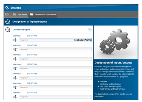

I/O designation
NO purchase option | ADDITIONAL hardware required - User I/Os and / or automation box
Have you always wanted to use whole words when naming user I/Os instead of dealing with numbers?
From now on, you can decide whether you want to name the user I/Os using letters and/or numbers to make assignment more clear.
Names can be created in the user settings. They can be used in SimPL to address the inputs/outputs. Changing the name is also easy the user settings, so SimPL programs do not have to be adapted manually.

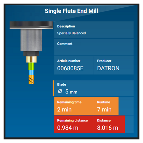

Running time display of current tool in status screen
As of version 3.0, a simplified and clearer overview of the distance already run and the running time of a tool is displayed in the status screen.
This enables the operator to quickly and easily get an overview of downtime.
Short film about the tooling distance

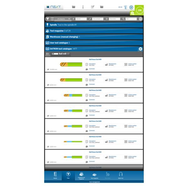

Tool management display
We have made the system more user friendly and are allowing for more space for the display of tools in the future.

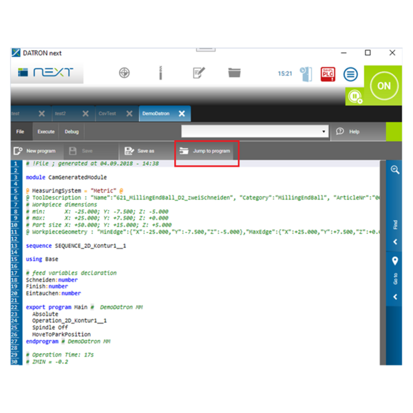

Editor expansion
A small step for our developers, but a big leap for the operator. For faster and easier navigation, a button for jumping to program management has been added in the editor.
You now have the option of jumping directly from the editor to program management to display the open program. This allows you to find, delete, copy your program more quickly, etc.

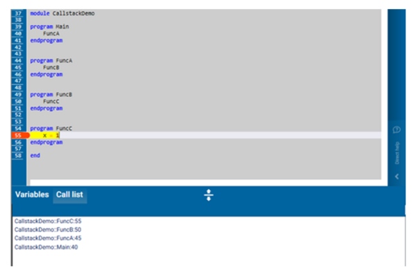

Call stack display during debugging
You want to debug a function that is called up from several places in the program and you don’t know from which one? This is how the new function can help you. You can see from which code point you have arrived at the breakpoint. You can click on the entries in the list, which also makes it possible to jump to the corresponding code points.

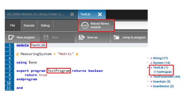

Display library modules in the library assistance
You like to write your own libraries and have a lot of functions?
In future, these will also be displayed in the library assistance.

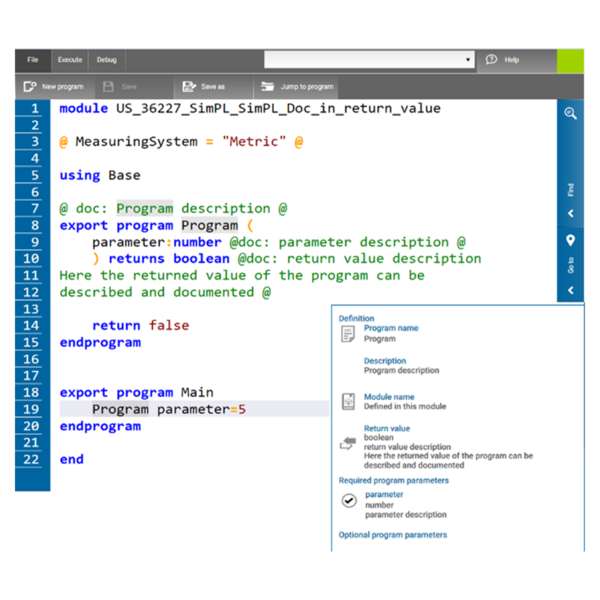

Allow SimPL-Doc for the return value of a program
SimPL-Doc @doc@ can now also be used for the return value of a program or function.
This makes it easier to write return values.

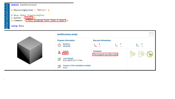

Functional extension of program management
From now on, the fields “author” and “comment” can also be used in program management.

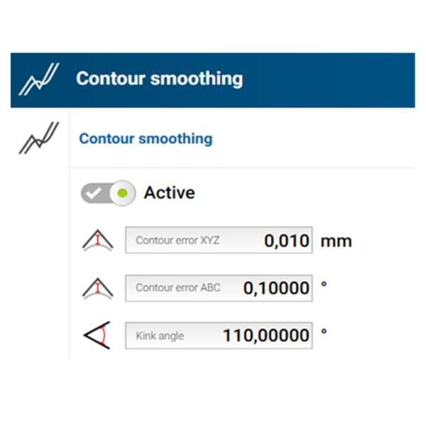

Standardisation of contour smoothing units
In manual operation, we used to use the micrometre (µm) unit for contour smoothing for the contour error.
In the program, however, the value was given in millimetres (mm).
This has now been standardised – in the future, contour smoothing will be specified everywhere in millimetres (mm).
