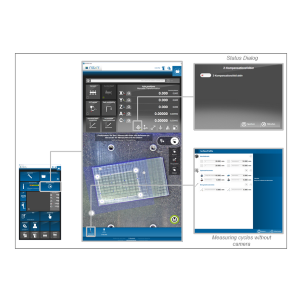

Surface Profile
Benefits of the function:
  • Height compensation during milling in blanks that do not have a flat surface profile.
Available on machine types: All
Known limitations: Not in combination with the rotary/swivel axes
Functions:

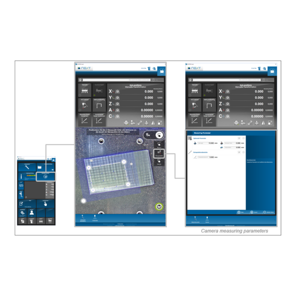

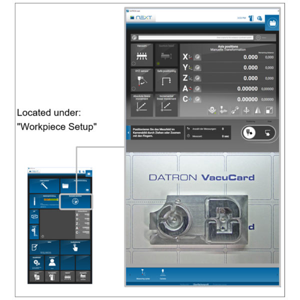

  • Manual “measuring cycles
  • Camera Measuring cycles
  • Special measurement parameters
    • Number of points in X and Y at which the Z-height is keyed.
    • Extrapolation areas (edge areas)
  • Status Icons:
    • Workpiece setup
    • RunScreen

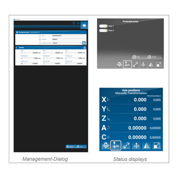

Protected Areas
  • Definition of areas in the machine or on the workpiece that must not be approached in the milling process.
Areas of application:
  • Protection of machine parts such as the vacuum plate or clamping device
  • Protection of areas in the raw part, e. g. semi-finished parts
Known restrictions: None
Functions:
  • Manual measuring cycles
  • Special measurement parameters for
    • Cuboid
    • Cylinder
    • Plane
  • Managing function
  • Status indicators
    • Workpiece setup
    • RunScreen

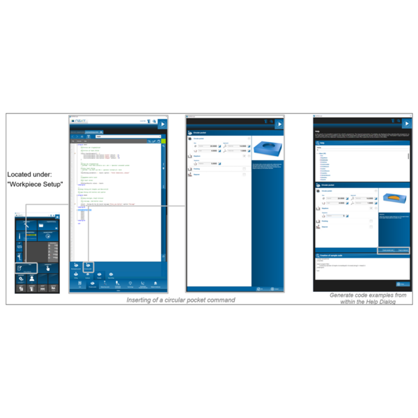

Dialog Based SimPL Editing
  • Simple creation and modification of milling programs directly on the machine – even without detailed SimPL knowledge
  • Editing CAM programs
  • Creation and editing of own programs
