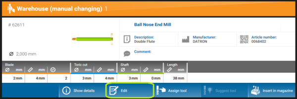

Edit tools directly in tool check
NO purchase option | NO additional hardware required
Existing tools can now be edited directly in the tool check without first switching to tool management. This saves time during setup, especially for programs that involve many tools.

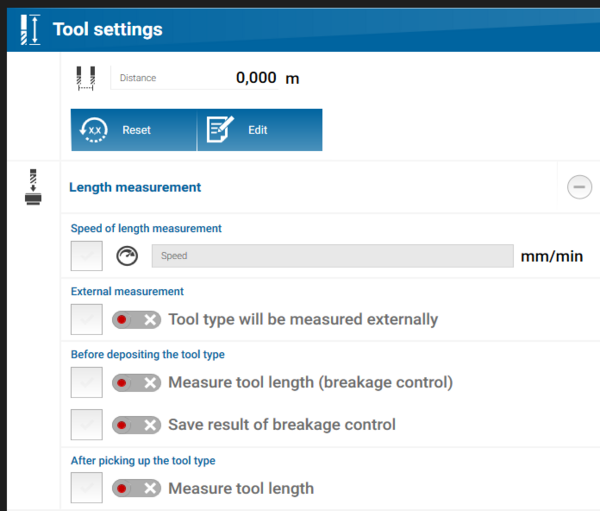

Configure tool length measurement per tool
The former global settings for tool length measurement can now also be stored per tool in tool management. This allows special cases - such as externally measured third-party tools - to be configured individually.

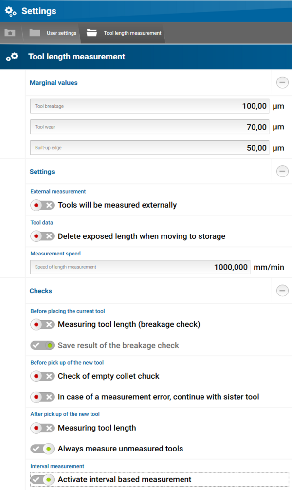

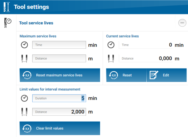

Interval based tool measurement
REQUIRED purchase option: Sister tool administration | NO additional hardware needed
Tools can now be checked automatically based on machining time and/or travel distance during the next rapid movement. If wear or breakage is detected, the software can automatically switch to a sister tool and continue the program from an appropriate point, if such a tool is available. This feature complements the existing breakage or wear monitoring during tool changes and is particularly useful for long machining operations using the same tool.

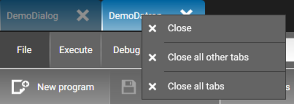

Close multiple editor tabs at once
Open editor tabs can now be closed in groups. The context menu (opened by long press/click) lets you close the current tab, all but the current tab or all tabs at once, making it easier to keep the editor workspace tidy.

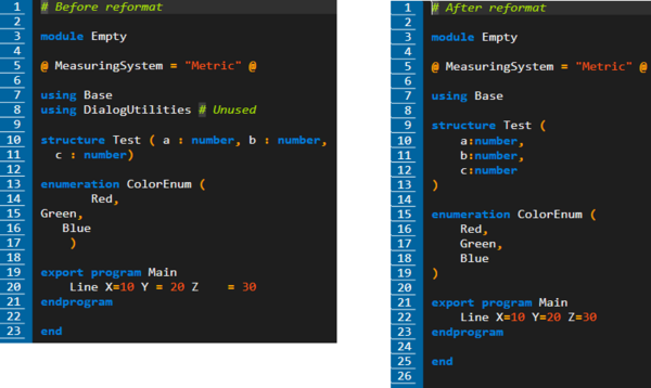

Automatic code formatting for SimPL modules
SimPL modules can now be formatted automatically using a button in the editor or the Ctrl+R shortcut. Indentation, spaces, line breaks, and parentheses are standardized, and unused using/import statements are removed. The result is clean, more readable, and easier-to-maintain code.

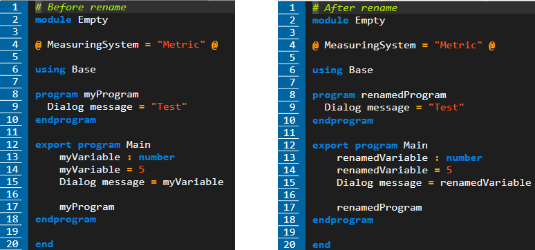

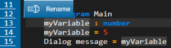

Rename SimPL variables and programs in SimPL editor
The SimPL editor can now rename local variables as well as programs/functions via a dialog - alternatively through Edit > Rename or with F2. All references within the module are updated automatically. The change can also be undone.
