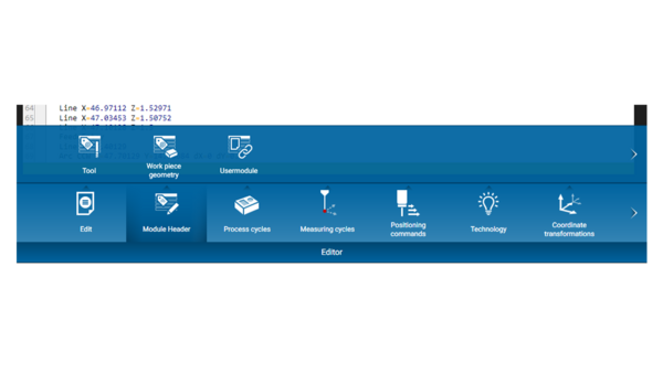

Creating a ToolDescription in the editor
For a tool check to be performed for a program, a tool description must be contained in the header of the program. From now on, this description can be conveniently created in the editor via a graphical input dialog.

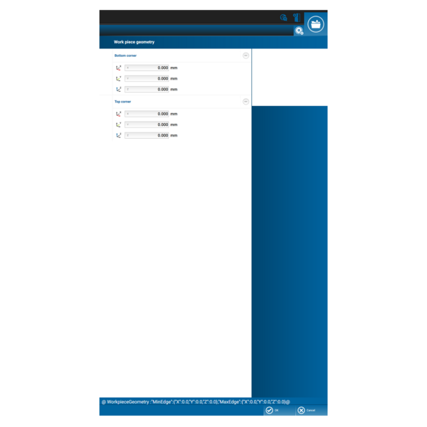

Creating workpiece geometry in the editor
For the graphical representation of the bounding box of the workpiece in the 3D simulation, the workpiece geometry (WorkpieceGeometry) must be defined in the ModuleHeader of the underlying milling program.
When programming in the editor, this can now be done very easily using an easy-to-understand input mask.

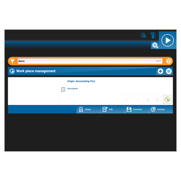

Search function in the workpiece management
The search function is now also available in the workpiece management. This allows you to find your stored workpiece origins quickly and easily.

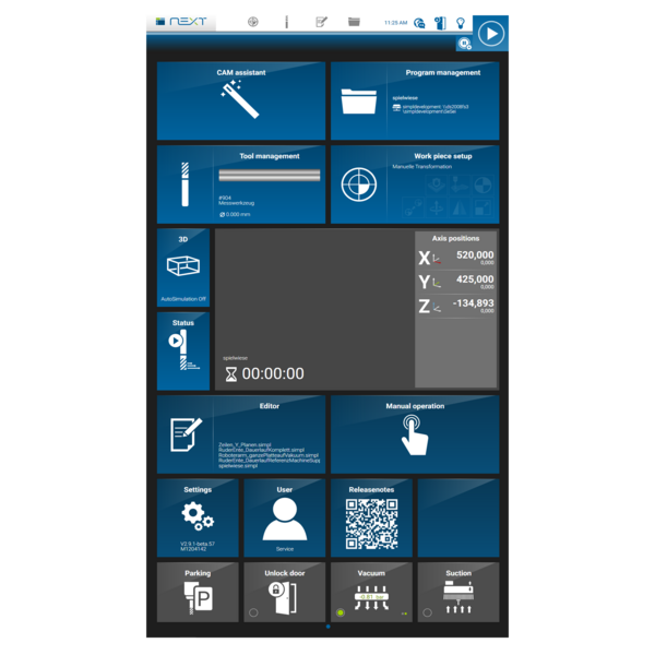

Display of the vacuum value on the home screen
In order to have an even better view of the vacuum value, it is now also available on the homescreen in the Vacuum tile.
Note: Please note that the value can only be displayed on machines equipped with a DATRON vacuum distributor.
