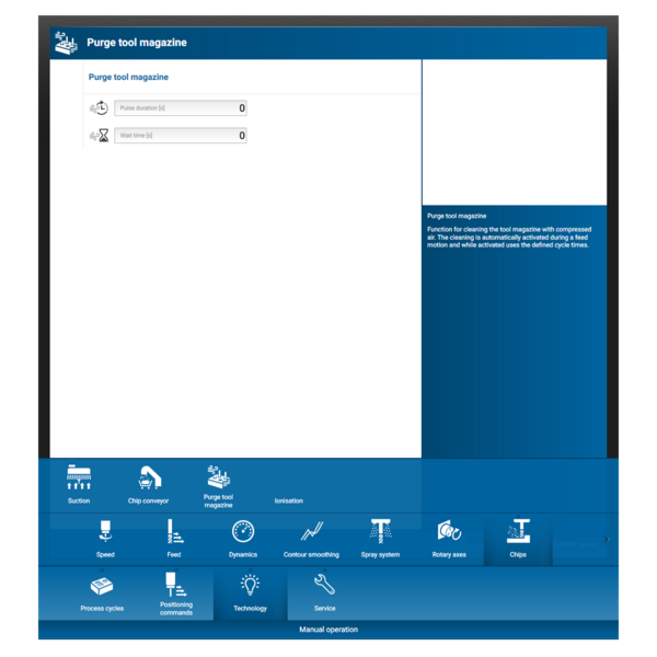

Adjustable parameters for the pneumatic cleaning of the tool magazine
In order to make chip removal in the tool magazine even better, the pulse and waiting times can be set individually as of now. This means that the blow-out cycles can be adapted much better to the respective type of machining.
Attention: This function only has an effect in combination with the 12-way changer with cover.

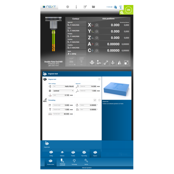

New function for simple engraving of text
A new engraving function is now available for performing easy marking tasks, such as engraving a number or a label on a workpiece.
A label can be created either via the dialogs in the manual operation or via a function call in a SimPL program.

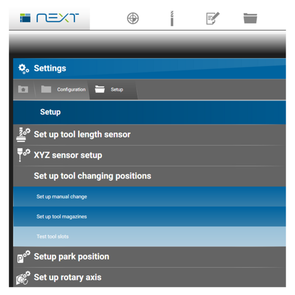

Setting up the tool changer by the operator
With Release 2.8, you as a customer can use the functions for setting up the tool magazine and the manual change position yourself. This is necessary, for example, if a tool pot is worn out or damaged and has to be replaced. In future, it will no longer be necessary to call in a service technician on site.
Attention:
Please note that a measuring adapter is required to calibrate XYZ. After replacing one or more POM tool holders, the tool locations must be checked and the replaced POM tool holders need to be set up. The following requirements must be met in order to do so:
  • At least version V2.8 of the machine control system must be connected to the must be installed on the machine.
  • The XYZ sensor is calibrated and the offset between the tool tip and probe tip are calibrated.
  • You have a measuring adapter if you use collets of the type use HSK-E 25.
  • If you use collets type HSK-E 32, the following is sufficient an empty collet chuck.
  • The affected tool magazines are empty.

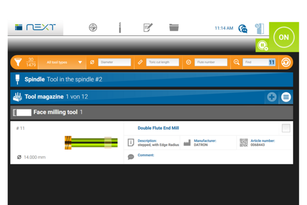

Filter in the Tool Management Dialog
You can access tool management in various ways. For example, if you tap on the illustrated spindle in the Manual operation area. Up to now, the filter function was missing if you used the tool management path described. It is now available.

Filter in the Tool Management now also considers tool number
The filter function in the tool management has been extended. From now on it is also possible to filter according to the unique tool number.
This number is assigned by the controller when a tool is used and is only available once on the machine.

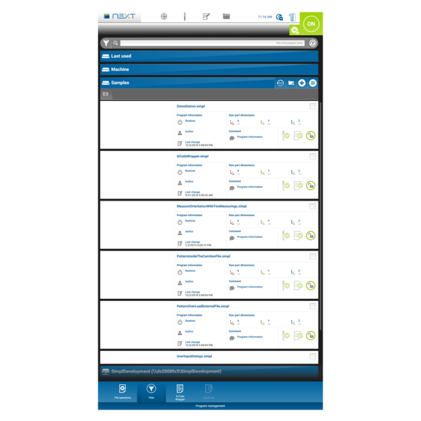

New sample files available in DATRON next
New examples are now available in the Samples folder of the program management:
DemoDatron.simpl
Serves in general to explain the structure and functionality of a SimPL program. This file is referenced in another program (PatternOverLoadExternalFile.simpl).
GCodeWrapper.simpl
Used for the translation and execution of GCode programs in the next controller.
PatternInsideTheCamGenFile.simpl + PatternOverLoadExternalFile.simpl
To illustrate the Pattern command, which can be used to execute a part at different positions in a grid.
UserInputDialogs.simple
To explain how to create input dialogs that must be filled in by the machine operator during program execution.
