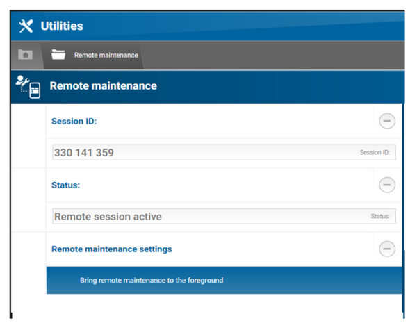

Adjustable proxy for remote maintenance
NO PURCHASE OPTION | NO ADDITIONAL hardware required
The remote maintenance window can now be brought to the front via button press in order to change the machine's proxy settings, if required.

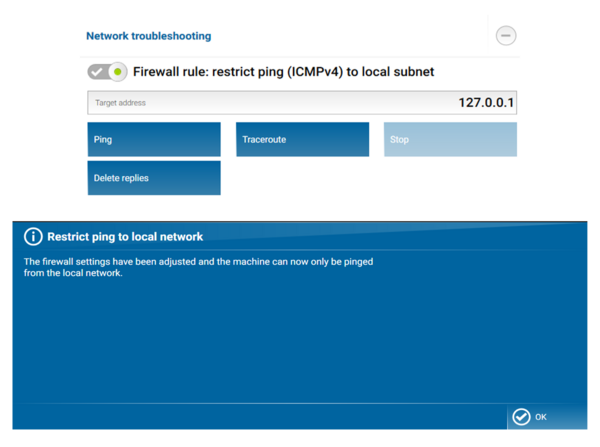

Restrict ping to local subnet
NO purchase option | NO ADDITIONAL hardware required
In the network settings, you can now specify whether the machine can be pinged from all networks or only from the local network.

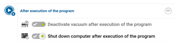

Deactivating vacuum and shutting down the computer after program execution
To prevent unnecessary energy consumption, the execution options now allow the vacuum to be deactivated after the program has finished. Additionally, the computer can be set to shut down. Both settings can be adjusted while the program is already running

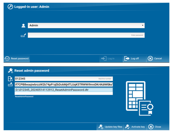

Straightforward help in case of admin password loss
NO purchase option | REQUIRED PURCHASE OPTION: User administration | NO ADDITIONAL hardware required
The administrator password can be changed in the user settings. If this changed password is lost, certain functions of the user interface can no longer be accessed. Therefore, there is now a dialog for resetting the administrator password by way of the license key.

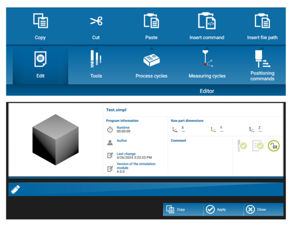

Pasting file paths into editor
It is now possible to use the new "Paste file path" menu option of the editor toolbox to directly paste a file path into the source code using SimPL syntax. Alternatively, the file path can also be copied to the clipboard first.

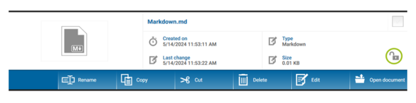

Displaying Markdown documents
Within the program management section, it is now possible to open Markdown documents (*.md) in a formatted view.

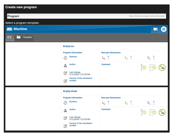

Templates for creating new programs
When creating a new program, a list of possible templates is now displayed that can (but do not have to) be used as the basis for the new program. So far, templates exist for both ISO and SimPL programs.
