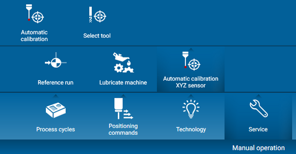

XYZ sensor calibration
Purchase option | ADDITIONAL hardware required: DATRON 3D Probe
The offset between the XYZ sensor and the active tool can now alternatively be determined using an automated, faster, and more accurate measuring method compared to the previous procedure.

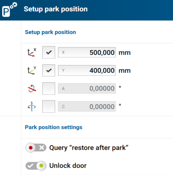

Keeping the door locked after reaching the park position
NO purchase option | NO additional hardware required
Until now, the door was automatically unlocked (or the lift gate automatically opened) after reaching the park position. It is now possible to configure via the park position setup menu that the door remains locked after reaching the park position.

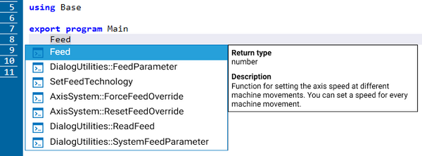

Code-Completion Pop-Up
In the editor, when using code completion, a pop-up is now displayed showing the documentation for the currently selected suggestion.

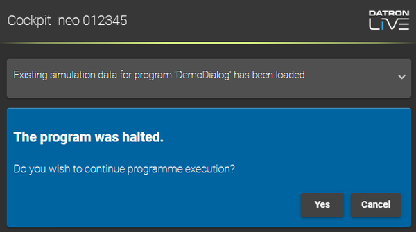

Displaying and confirming NEXT dialogs remotely
NO purchase option | REQUIRED software option: REST API / DATRON Live
NEXT dialogs can now be displayed and acknowledged both via the REST API and through DATRON Live.
