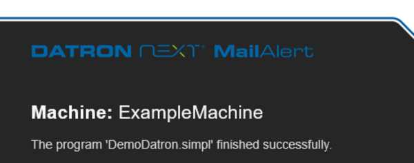

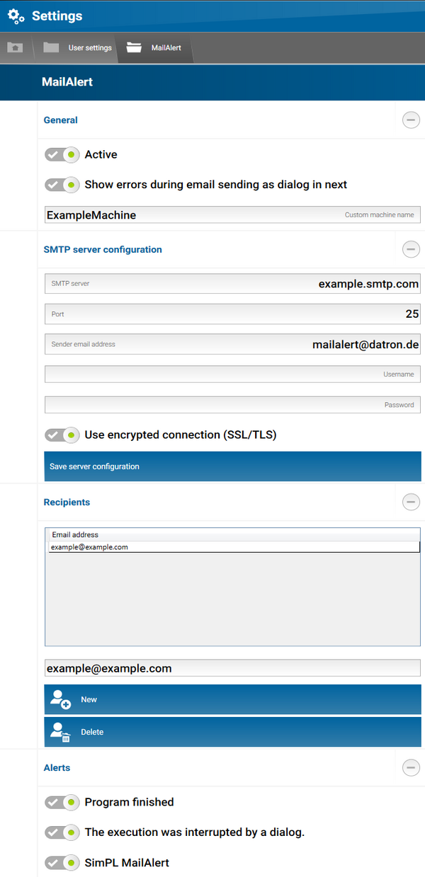

DATRON next MailAlert
Purchase option | NO additional hardware required
The machine can now send emails. It can automatically send them on specific events - for example, at the end of program execution or when execution is interrupted by a dialog. In addition, the new SimPL command "MailAlert" lets you send custom notifications.

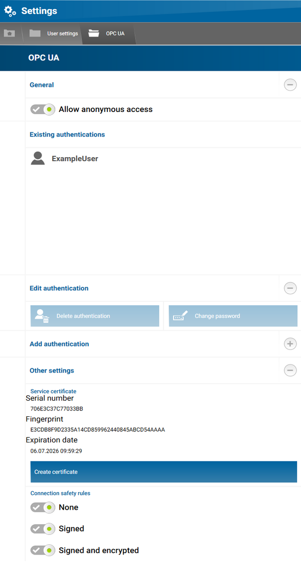

OPC UA Interface
An OPC UA interface allows an OPC client on the remote side (e.g., UaExpert) to retrieve current machine information. As with the REST API, a user management system is available; anonymous access can also be enabled if required.

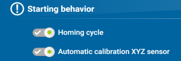

Automatic XYZ Sensor Calibration at Machine Startup
NO purchase option | REQUIRED hardware: DATRON 3D Probe | REQUIRED software option: 3D Probe Calibration
Analogous to homing and spindle warm-up, the automatic XYZ sensor calibration can now be enabled in the “Startup Behavior” dialog for machine startup.

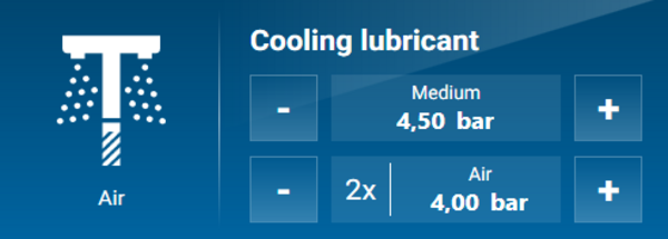

Control of the Spray System During Program Execution
NO purchase option | REQUIRED hardware: spray system (proportional valves)
In the "Coolant/Lubricant" view, machines with a proportional valve can now adjust the pressure during program execution in 0.5-bar increments. At more than 6 bar air pressure, the system automatically switches to two containers, where available.

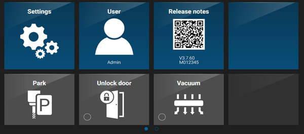

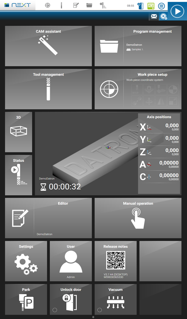

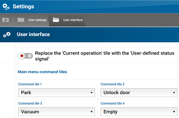

Configurable Command Tiles on the Home Screen
NO purchase option | NO additional hardware required
The assignment of the gray command tiles at the bottom of the home screen (e.g., Park, Door release) is now configurable.

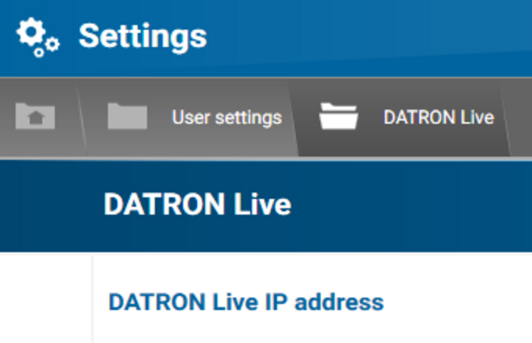

Display IP Address for DATRON Live
NO purchase option | REQUIRED software: DATRON Live
The machine’s IP address used to access DATRON Live is now shown in the corresponding settings, making it easier to connect from other computers.

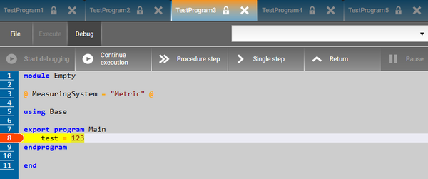

Highlighting Editor Tabs at Breakpoints
When an editor tab is paused at a breakpoint during debugging, the tab is highlighted, making it easier to find it among multiple open tabs. This applies to debugging both SimPL programs and the SimPL PLC.
